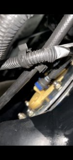

Could be. I purchased mine about a year ago. Here is what the Titan tank seal clamping mechanism looked like on mine. If you don’t evenly torque all the bolts multiple times, then it will very likely leak as you can see in the picture.
