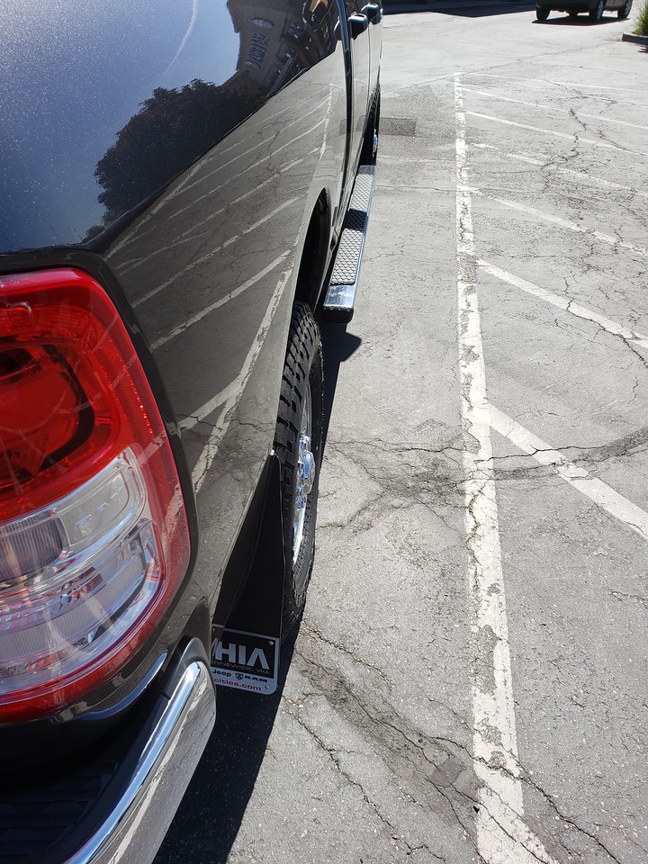

I am interested as well. No plans for a lift/leveling kit. How big can you go before rubbing?
Tires are on.
They fit well with plenty of clearance, do not rub, and seem to be very quiet. The odometer is off 5%, but the speedo is only about 2 mph slow at 70. All in all, I'm very satisfied. I hope they are good in the woods.
