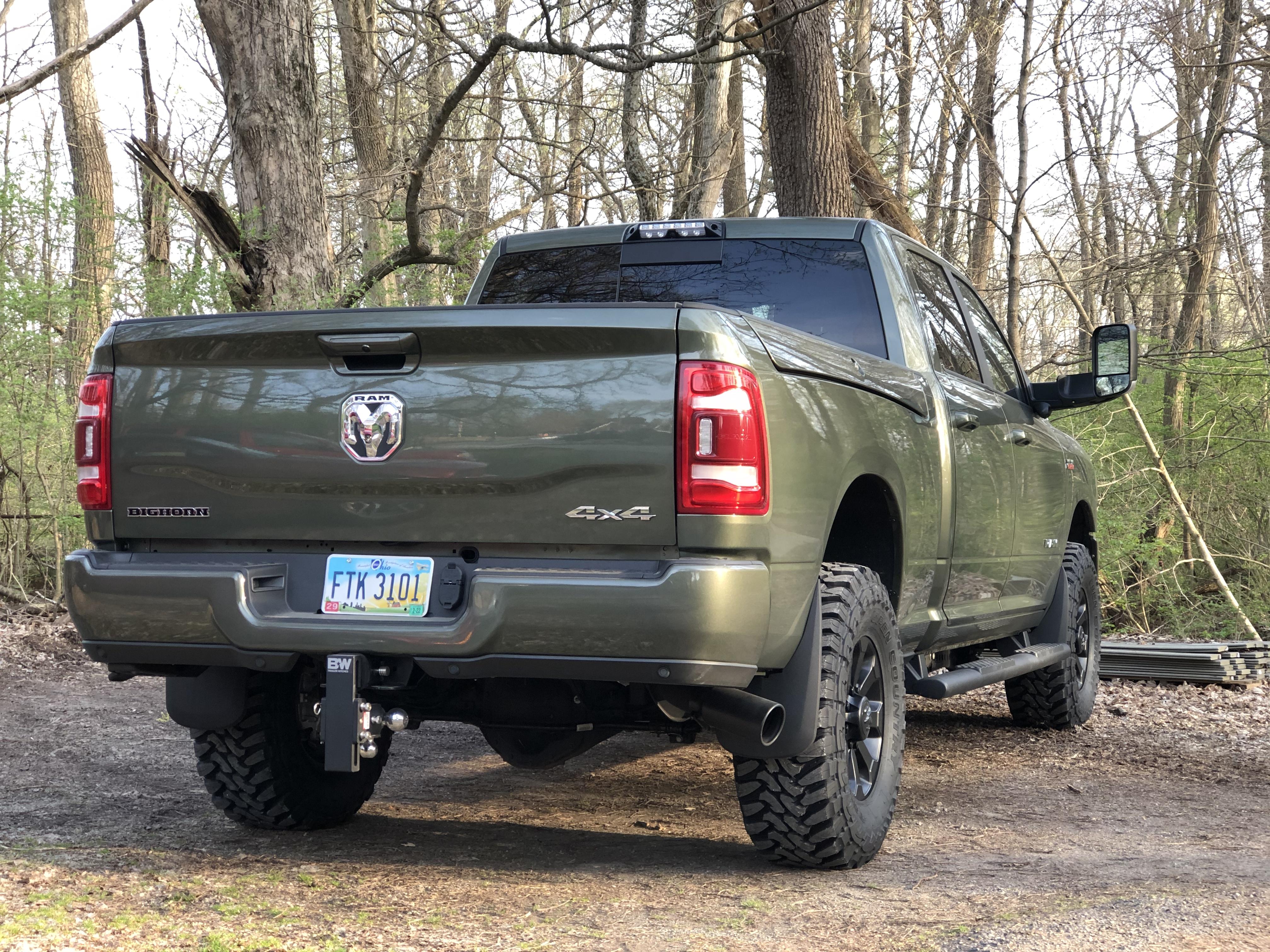

I slightly rotated the resonator upward, painted it black using VHT header paint and installed a Spectre tip after I installed my Solo Performance muffler delete pipe.
Nice truck man!
Is that tip just a bolt on or is it welded?
