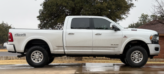

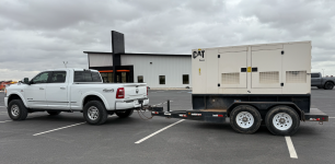

I have what you are looking for and love it (see my sig for all the details), here are a few pics... I do some towing, off-roading, highway trips, it's a great combination for me!

It definitely rides better than stock - just don’t expect ½-ton plushness. The Carli Kings are firmer than the Fox shocks I had before. They feel more “sporty” and controlled, not floaty. The extra front clearance also helps the suspension do its job a bit better.
I’m running the Carli front sway bar. I like it, but it’s not the night-and-day change some people make it sound like. I’ve tried all the combos: no front sway bar, no sway bars at all, and now the Carli bar. On a completely stock truck, removing the front sway bar actually made the biggest single difference in ride quality.
If I didn’t tow every now and then, I’d probably run the mid-rate rear coils with longer shocks. But for what I do, this setup works really well.
One more thing: going from stock 20s to 17" wheels with 35s - and running proper tire pressure - made a bigger improvement than any of the suspension parts. Wheel/tire setup is way underrated compared to shocks, coils, and sway bars.

Also, in the first pic, side view, where it's quite level, I had about 2,000 lbs in the bed...
