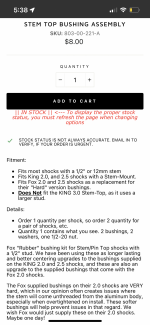

Thuren now offers a better rubber style bushing vs the harder rubber style on the foxs. This is $8/ shock.
