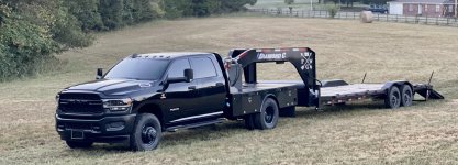

Anyone running the Thuren 1” leveling kit or have pictures of one? I’m looking into this kit for my 3500 C&C truck. E177E6E7-2536-4037-803C-A87643A419E7.jpeg
I run a 2” and it sits right at 2”. Maybe throw a jack under the front frame of your truck and jack it up an inch if you want to see exactly how it’s going to look.
The 1" lift is accurate for the 2500 models only, The 3500s and up come .25" higher than 2500 models from the factory so the Thuren springs will net you .75" of lift. If your after a true 1" lift I think your only option is a spacer such as the Traxada.
