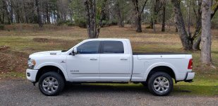

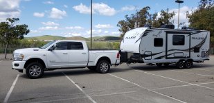

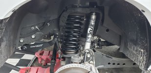

I did the Thuren 1" coills, front sway bar and Fox 2.0 shocks on all four corners. Couldn't be happier! I didn't do the rear coils because I tow a trailer with about 400lbs in the bed when I do and didn't want to do air bags. Worked out perfectly, ride without trailer is way better and even the rear is smoother. With trailer it's about 1/2" higher in the rear after adjusting the WDH. One oddity is that the coils actually lifted mine 1 1/2" which I actually like better, figured it would settle down but it never did with over 3K on it since doing it.
View attachment 16573View attachment 16574View attachment 16575
