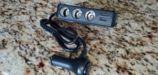

Have you considered one of these 3-way splitters?
Model CC1009
It has overcurrent protection with a digital amp meter. You can turn off individual ports or the entire thing.20200518_151027.jpg
Here are the product specs.
It also has 3 USB 2.4A ports and one QC 3.0 port.
