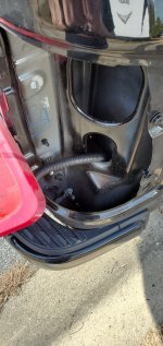

So I discovered existing ball mounts behind the passenger side brake light on the 2500. They must be behind the driver's side on the 1500 because the directions stated it
Well, still won't work since the piston is pressurized and would actually do the opposite if installed

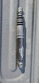

Oaklandopen. There is an OEM assist damper that can be ordered. Part number 68362518AA. Ordered from Moparparts,Inc. Can get the friends and family discount on accessories until the end of the year. Just received one today and my Bighorn model 2500 has the ball mounts behind the passenger taillight. About a ten minute install. Works very well.
Done with OEM part. Got it from the dealer, about $40 and picked up today after ordering yesterday
