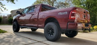

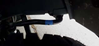

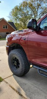

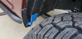

After install the Carli leveling Fox 2.0 with AEV wheel and 37x12.5 17R Geolandar ATX the front tires are rubbing the sway bar. Is there any after market sway bar that could minimize this issue? Not sure if this help but I have not get an alignment yet.
Nice truck! Looks a lot like mine.
Are you Rubbing on both sides of sway bar or just one?
Adjustable Track bar?
I have a Carli Sway bar on order and it should be here in 4 weeks. The Carli Sway bar looks like it will gain some space over OEM.

Thanks. I already have the adjustable track bar installed also. It is rubbing on both side on full turn lock. I'll have to chat with the Carli people and get some idea from them.
I am on stock suspension on 37x13.50r18's and I rubbed on the sway bar at full lock. Just installed the thuren sway bar today and it opens up an inch maybe two from the stock sway bar. I stopped rubbing on the sway bar after install. It's my understanding the thuren and carli are very similar. I didn't do too much after installing but it is a nicer ride hitting big potholes slow, and pulling into my driveway.
Do you have any rub on the radius arm?
I just saw a post this morning (can’t find it at the moment) but a user mentioned they added the thuren sway bar and it fixed their rubbing. Hope this helps.
I had a very slight rub on my stock swaybar after going to 37s. I do not rub after adding the Carli swaybar but I also lifted the truck 3" at the same time so not sure what helped more.
Carli or Thuren both make swaybars. I talked to CJC Offroad this week and it sounds like they have Thuren sway bars in stock. Carli is going to be a bit of a wait, I don't know the exact time.
