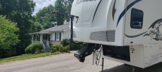

I swapped OEM for B&W turnover.
It appears your truck is a megacab. Are you using the Reese Goosebox? If so do you have an offset ball? Does the nose cap get too close when making a sharp turn?
