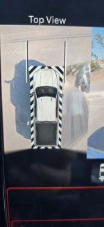

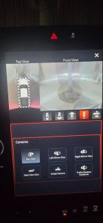

I ahve 2023 Ram 2500 on its way after it was restored from the flood. We have replaced the module because the original one was damaged. It shows all cameras individually, but doesn't display top view. They tried to calibrate it in the shop, but couldn't get it done. I was wondering if 2023 can be calibrated the same way as previous models using AlfaOBD.
My experience with the Newer CVPM (2022+) into a 2021 that already had surround cameras.. THe “top view” is a synthetic image, once all the other cameras are calibrated (using AlfaOBD). However, I had to calibrate the cameras individually, and I had to be in an area with really good “parallel” lines (stripes) on the road, so the cameras and CVPM could “see” them during calibration. One camera at a time (Front, Left, Right, Rear) with code clearing each time. Once they were all individually successful, the “Top view” image appeared. YMMV.

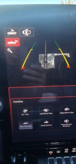

Ok so I just finished my install everything works Except the rear camera i do have the guide lines just no picture would I need to replace the oem rear camera?
Also from the cvpm the one labled (back) is that one supposed to plug into the rear camera cable behind the radio the red plug??
