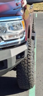

Just showed up on the front porch and the first one is beautiful! 17x8 with +15 offset.
My appointment is on Wednesday to have new Mickey Thompson Baja Boss ATs in 255/85R17 mounted on them. Hoping the factory chrome center caps will work on them for a total retro look.
Kind of a small tire for a big truck, eh? Would be nice if that wheel was 17x9" with 35mm offset and > 3,500 lb load capacity.... then go with a 35x12.50. My wheels are 17x8.5" forged aluminum, with 25mm positive offset. The reason I would like 35mm is too have minimum poke while still clearing 35x12.5 tires (from my measurements, I have about 1/2" clearance to my radius arms at full lock, with 10mm less poke, I should still [barely] have clearance. Post photos, very interested to see what it will look like :P

Looks good. Had this size on another vehichle and really liked them. Are you stock suspension? Can you post a front, side, and rear picture? What did you do for center caps? What tire pressure are you running?
Thanks
Thanks
1. not stock suspension. I had a Tuff Country leveling kit added. 2" IIRC.
3. Center caps are the standard black ones from MT that came with the wheels.
4. No idea of the tire pressure. TPMS sensors have not synced yet and haven't had time to go to a local shop to have them programmed.
