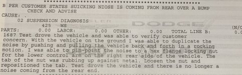

Ok everyone, potentially some good news here. I had to be pretty firm with the dealership this morning, sent them the squeaking video of the brakes (they later said that wasn't it), insisted the tech needs to drive it and duplicate. I got a call a few hours later and they assured me it was fixed and I've already picked the truck up.
It did not squeak on the way home. I took it through the usual speed bumps that cause the sound, and I couldn't hear it anymore. I'm going to give it a few days to a week and then circle back here because once or twice the squeak has stopped completely on its own only to come back in full force a day later for no reason at all. Hopefully this does the trick but I won't be certain until a few days from now.
I'm including a picture of my service report that gave a pretty detailed description of how to duplicate the sound, where the issue was, and how they fixed it. I hope it's of some help to any of you that have this issue. Let me know if you have troubles reading it.

Thank you for staying so on top of this, Mark. I probably should've had breakfast first as I was more than a little bit irate as I left the dealership this morning when I wrote that post. If it comes back again I will most certainly start a case with you. For now, we'll see if it stays gone.
Thanks again!
