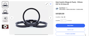

2. The bolt pattern you noted (8x165.1) is accurate so no worries there. However, the stock center bore is 121.3mm so using a wheel with a 125 mm CB will be bigger than stock. The upside is it'll fit on with no issues, but the nuance is that you're no longer hub-centric. That means you'll be relying on the lug nuts to center the wheel onto the hub (aka lug-centric). 3.7mm is fairly small (roughly 1/8") but you may be able to find a ring to fill the void. **Not a spacer to push the wheel out more, a "hubcentric ring" to center the wheel on the hub.

Concern #2 solved.
I should have looked before responding. A quick search on Ebay and they're $20 for the set of 4.
Crank the wheel hard over when you get the truck to see if you have 1.4" of clearance. If so, buy the rings, and you're all set with the set-up you asked about.
