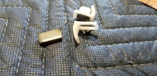

I did that seat back mod on my 2016 1500 Eco. You don't have to unbolt the seats, just loosen them enough so you can raize the seat back up enough to unhook. Those bolts are in there tight, be sure you have a good extension or cheater bar.
I used a hacksaw and cut 5/8" off, just to the white plastic.
Here's pics:
Rear Seat Hook-Original.jpgRear Seat Hook-Modified-2.jpgRear Seat Hook-Modified-1.jpg

To be able to fold down the rear seatback to access a little more storage space.
The seatback is still hooked and secure if folded down or up, but when at a 45* angle, you can pull the hooks past the catch on the back cab wall.

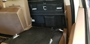

I have a 2020 it is a 60- 40 split also . I can pick up the seat bottom and the base flips out to make a flat floor . you can also access the back in th e rear to put a few things you don't need

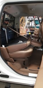

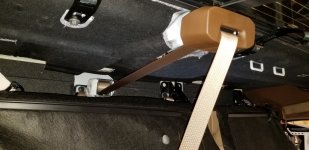

I did mine yesterday. I guess every truck is a little different, I had to cut a little more off than usual and round my end off to get mine to work smoothly. I wish I had done this years ago on my old Ram.

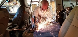

I couldn't find my Hack Saw so I used my Disk Grinder.. NO, I didn't catch my beard or set the truck on fire, but those sparks were hot!.. You should have seen the wife, she was taking the picture and having a duck at the same time.
