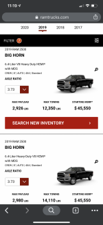

So what are my actual numbers?
Cowboyup1494
19
38
13
Was curious tonight about what my tow numbers were exactly for my 19 2500 cclb 6.4 big horn. With 3.73 rear. Ram site gives two different numbers based on two different variations of how they specify the 6.4. One “v8 heavy-duty” the other “heavy-duty v8”
We have a thread on this that explains it pretty well.
To start with the configurator is wrong for payload, and Max tow is figured with 300 lbs for passenger and 70 to 150 for hitching equipment.
The configurator is only for a configuration.
That said. I have no idea why they are stating the Heavy Duty V8 2 ways.
Very odd
Looking at it a few times, it seems the difference for towing is the difference between 3.73 and 4.10, even though 3.73 is selected for both.
Also odd is payload changing as it doesn't from ratio to ratio.
Very odd.
If you want to get your Max Tow. Get the payload number off of your tire and loading sticker off of your driver's door jamb.
Subtract it from 10000lbs. That gives you your base weight.
Then with the 3.73 gears your GCWR will be 21500. This is what your truck, all its contents, your trailer and all its contents can weigh.
Max tow is rated at 14220, but that is saying you will only have 450 lbs max in the truck.
I think you will get the idea how it isn't a real number, just a starting point.

Great explanation. I had decent handle on the payload sticker number and what that gave me. Guess I was mostly looking for that 21500 number along with the 14220 you provided.
I’m not too worried about the numbers as my 5th wheel gvwr is 10k and that’s the most I ever pull. Just nice to have the numbers to keep in mind. So loaded correctly I’ll have about 2k pin weight which leaves me about 1k payload for passengers toolbox, hitch etc.
I’ll have to wait til spring to get it all on a cat scale and I’ll know exactly where I’m at! Even if it is mostly just out of curiosity at this point.
The towing guide is not your real numbers. It is based on a configuration.
The only numbers concrete are GVWR and GCWR. Any payload or max towing number is not specific to the truck.
1500 specs are way off if you buy a higher trim.
2500 specs on higher trim is closer.
3500 is the closest, but still not going to be your trucks specific numbers.
And remember, the towing "max" is based on 300 lbs for driver AND passenger, and 70 to 150lbs for hitching equipment.
Find the section where you type in your VIN.. that will give you the real numbers. https://www.ramtrucks.com/towing-guide.html click on "look up my vehicle"
