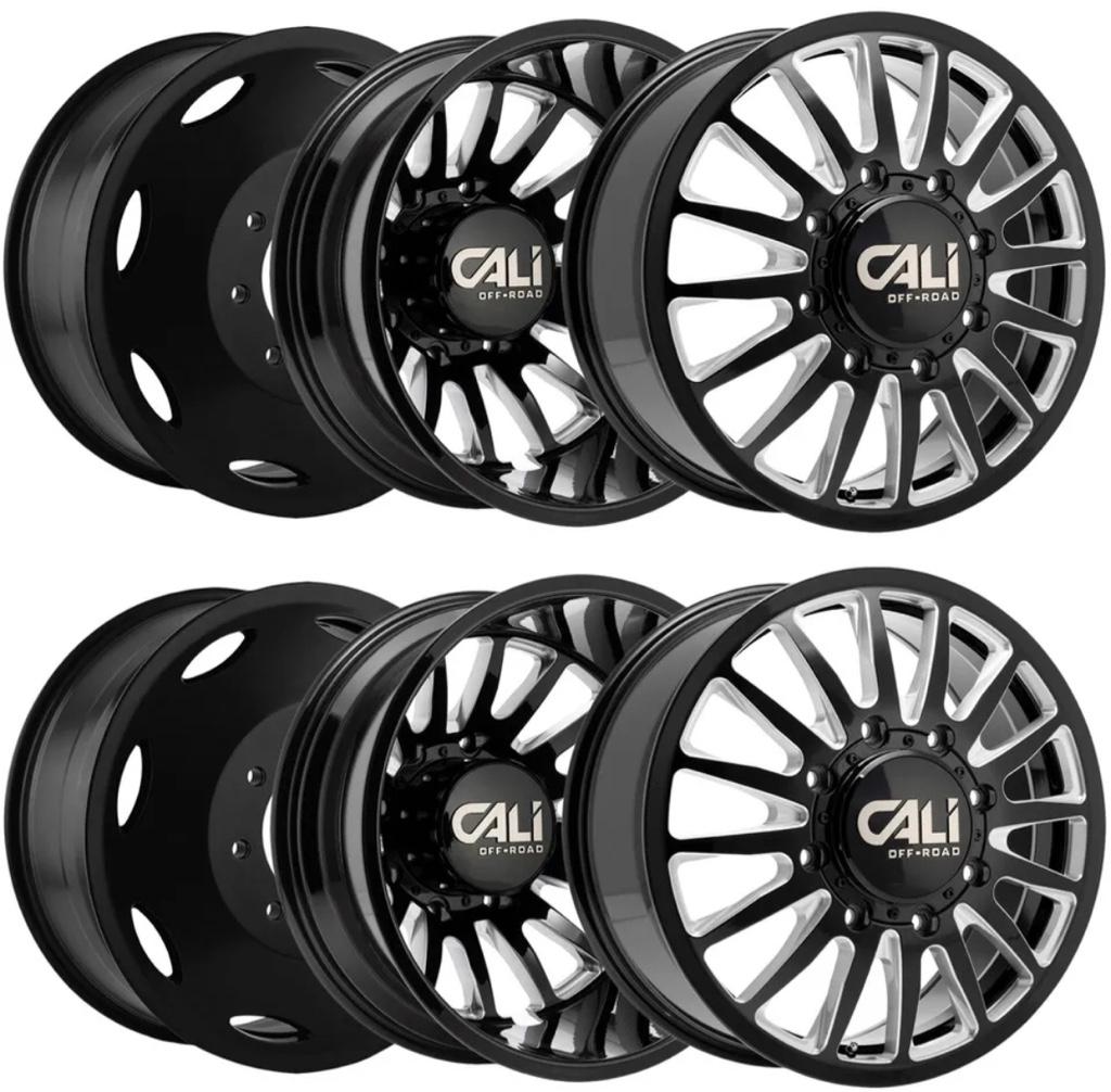

Thats going to ride like crap but they should fit problem free…
Not sure on the width of those wheels (you should have a minimum of 8” wide) but yes they will fit with no rubbingThanks for the info on this guys.

35 12.5 R20’s will fit without rubbing with stock height?

Im not sure what the offset of the front on those but I ran 35x12.5x20 MT on Fuel Triton dually wheels stock height no rubbing. I will say the tires i had were small for a 35. another thing to look at on those wheels is the rear offset, you may not be able to run the 35x12.5 in the rear depending on the offset they may touch the leafs and or each other. you should be safe with the 275/65.Thanks for the info on this guys.
