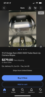

Here is a link to look at:
It’s on eBay, it’s a used 1 year old RAM Factory camera system to include the Camera and Cable…..$279.00
I would’ve bought something like this if there would have been any for sale at this price, but there wasn’t and I still don’t think RAM will sell just the cable/pig tail.
