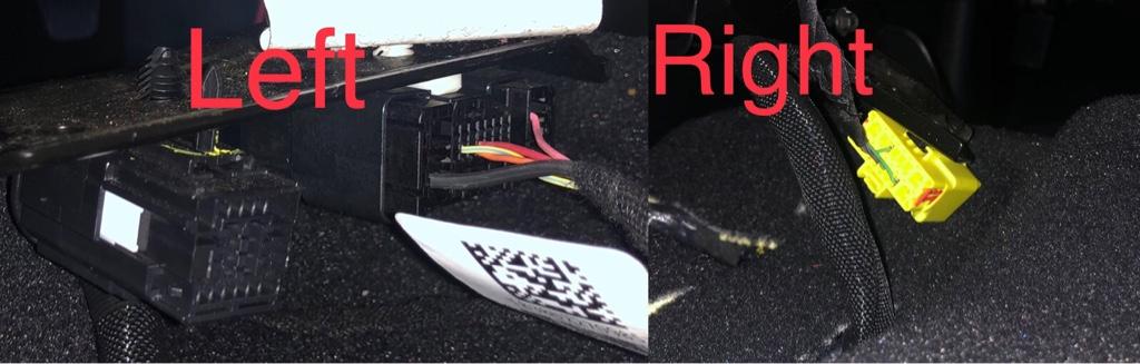

These are the harnesses that I could see without removing the drivers seat. I'm assuming that the yellow plug has a female counterpart on a power/heated/vented seat?
From what I've read, upgraded seats are plug and play. I'm trying to find some heated/vented seats on car-parts.com and it's super frustrating. I don't even care if the leather is in good shape b/c I'm going to cover them with katskinz.
Yellow connectors are usually airbag
