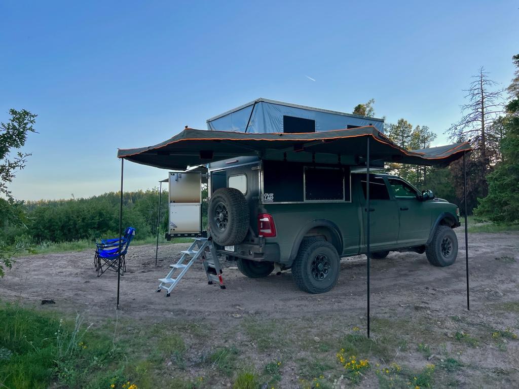

Wracking my brain trying to find the best way to route a 6AWG wire in convoluted conduit from the battery, along the frame, and up into the bed. I have a pop-up camper shell with a RedArc power management system installed on the front wall. The cable is for the DC-DC charging aspect as I’m running LiFePo4 batteries in the camper.
The bed is bed linered from the factory (‘21 Trade Wagon). I thought I could run it out the slot where the tire down rings come out, but it doesn’t fit with the conduit. So…to my mind…my options seem to be:
1) Use a right-angle drill with a step bit and open up that slot from underneath.
2) Drill a hole elsewhere, source a properly sized grommet, and run through there. Of course the bed liner covers the access holes with convenient snap-on covers
I can’t access the top rails the camper rests on them. I also only have 25-ft, so not enough to run all the way to the back of the truck and to the front of the bed.
Any thoughts? Any gotchas I’m missing? Am I wayyyyy over thinking this?
