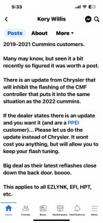

(Rumor) Ram locking down ecm’s of 19-21’s?

That turned out to be just a change in the (3rd?) CRC Ram added to the PCM code and the tuners took a while to get up to speed.
Makes sense. Pretty sure RaceME disables checksums, so wasn’t a problem for me.
Just adding to this, I just had P6401032PC installed in my PCM today while in for the DPF filter being full. No idea what changes it has (I had P6401032PB).
