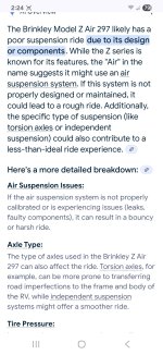

It might be the trailer. On our 2023 ORV Backcountry Series one of the axles was damaged during manufacturing. I found it just prior to the 1 year warranty expired when I removed a tire. The axle assembly was entirely replaced. View attachment 87989
I'm not sure I can add much but I'll say this is 100% wrong.
