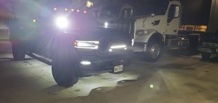

Just got pictures. They have not moved since i attached them, they can be moved and angle adjusted.

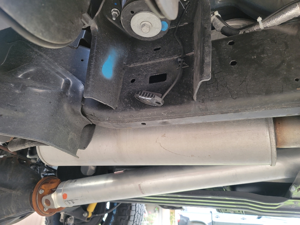

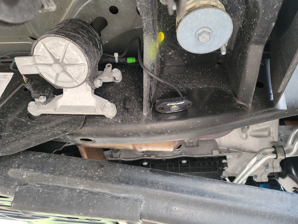

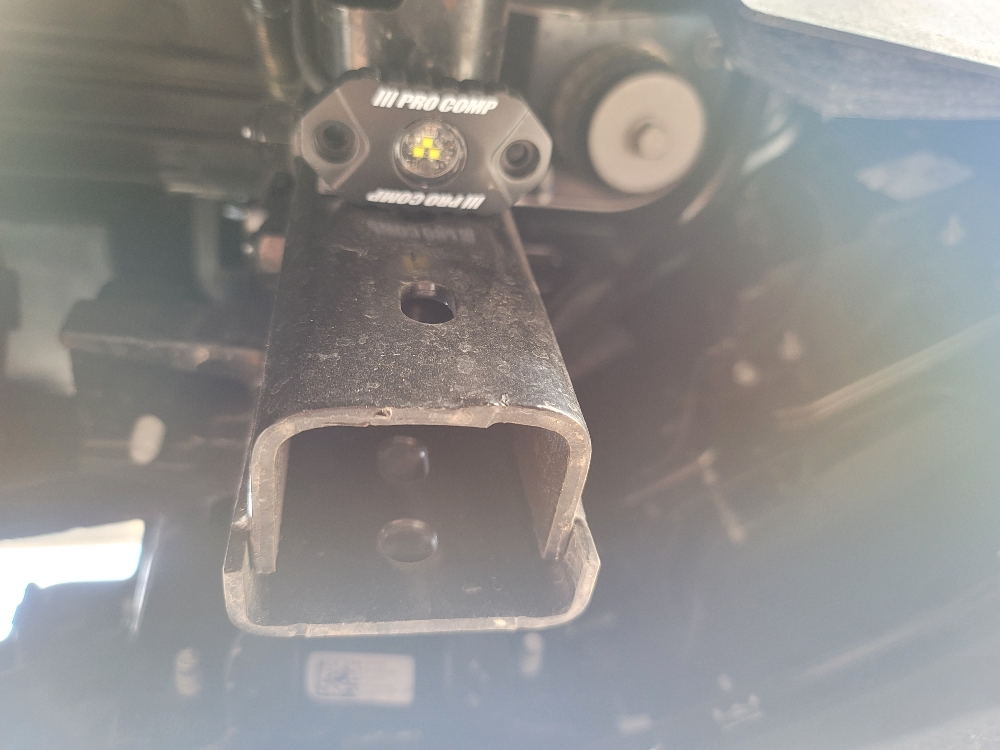

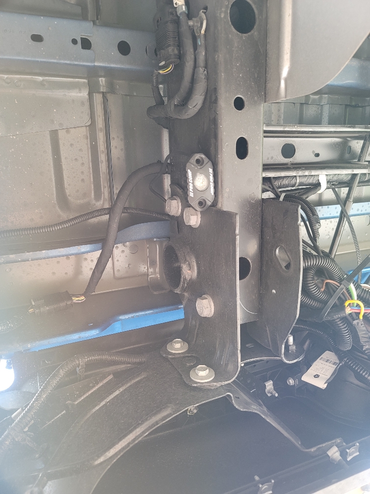

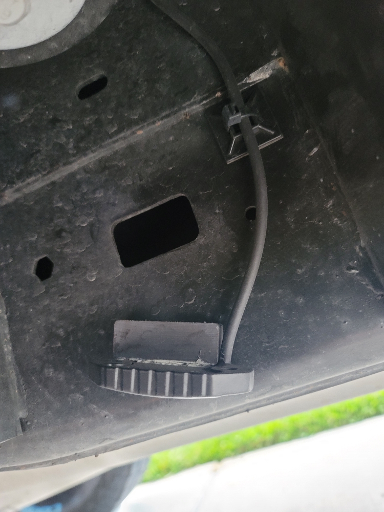

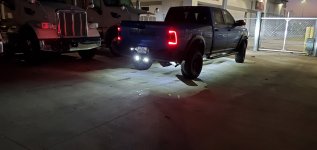

I just installed the Lux MAX white rock lights, 8 pack with 20ft leads.
I put one on each ends of the rock sliders, two in the front frame rails by the compatibility brackets, and two on the frame rail by the spare tire.
I put the junction box inside the passenger fender right by the hood prop you can slide it down. It is magnetic, but I found not magnetic enough after just the first drive, so I added 3M VHB tape.
25ft was not long enough to reach from rear driver side to the front passenger fender, I had to add a few feet of wire from one of the shorter runs.
The lights are bright and disperse the light great. Awesome light spread with no hot spots.
Sent from my SM-N986U using Tapatalk
Did you epoxy the magnets to the back of the lights?
