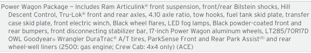

The winch is part of the core PW equipment group.
It should be but if you look on the build and price site “front electric winch” is in the list of items for level 1 equipment group. It might be an error but who knows with that garbage website. I just checked and I don’t see it listed in the level 2 list and if you option level 1 it lets you keep the floor shift and center seat but a few months ago it would automatically select electronic shift on the fly transfer case with level 1. Also, level 2 used to list the winch. As of now if you don’t select the level 1 group the picture doesn’t show the winch on the truck.
Yeah it appaers to still be part of the Tradesman "Power Wagon" package; but for the "Power Wagon" trim it looks like you have to get at least the "Level 1" package now.
Yeah I don't know, but it very specifically calls the winch out as part of the PW Package in that text you pasted.
Where is it called out as a line item accessory other than under the umbrella of the PW Package? Looks like the Level 1 Equipment Group specifically excludes it other than on PW to me.
ETA: I think the issue is them blurring the lines between Rebel and Power Wagon.
"Power Wagon Package" irrespective of trim levels (Tradesman or Power Wagon) calls out a winch.
It looks to me like to get a winch on a Rebel you have to buy the Level 1 Equipment Group
ETA@: I just went and built one and you are correct that you have to add that equipment package before the winch shows up in text or the "build image"
“Power Wagon Package” is the Tradesman Power Wagon
Power Wagon, the trim level, no longer has the winch. Note that it is listed as “P” for “Package” (Level 1 package)
(“O” is “Standalone Option”, “•” is “standard”) The winch is a standalone option on gas Rebels.
