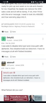

I screenshoted a post from @Jimmy07 previously helping another user regarding the BSM messages. (I'll attach the screenshots I used) it was from like January 31, 2020.
Using that and another forum post (Sorry I cant see the name of the person the screenshot cut it out but I will include it). I was able to clear the "Blind spot monitoring unavailable service required" message off.

- Doors: Blindspot mirror present
-No
- Cust.Set.Menu 1: Blind Spot Alert
-No
- Programmed ECU Cabin Net Right blind spot sensor
- No / same for the Left -No.
That seemingly got the BSM issue resolved.
