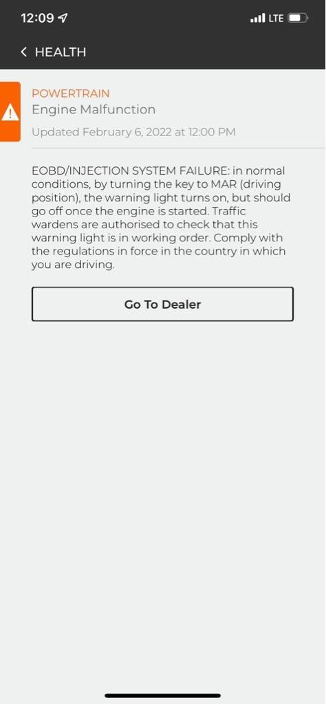

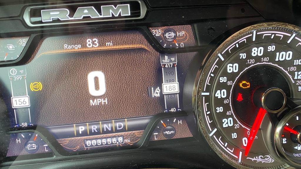

Good morning everyone. I’ve been having a reoccurring/ intermittent issue with my new 2022 3500 HO. At around 3,500 miles my CEL illuminated while under normal driving conditions. The truck was running fine with no sign of an issue. I immediately took the truck to my dealer since I was in the area anyway. They scanned the truck and came up with a code (I forgot the number) that stated “Reductant low flow detected”. I spoke with the technician who crawled under my truck to check to make sure there wasn’t anything physically wrong with the emissions system. No sign of an issue externally. Their best guess was that an “air bubble” went through the dosing unit and caused the code. They suggested clearing the code and adding a little fresh DEF to the tank (I was at approximately 1/4 full) and driving the truck to see if the code would return. I drove the truck another 2,000 miles without an issue. Yesterday the CEL came back on. Again, no noticeable change in how the truck runs or drives. I checked my Ram app and the code caused an “alert” in the vehicle health section but it does not give the code. I have an appointment today after work to get the truck scanned again. I’m thinking it’s the same issue related to “Reductant no flow detected”. Anyone experiencing similar issues?

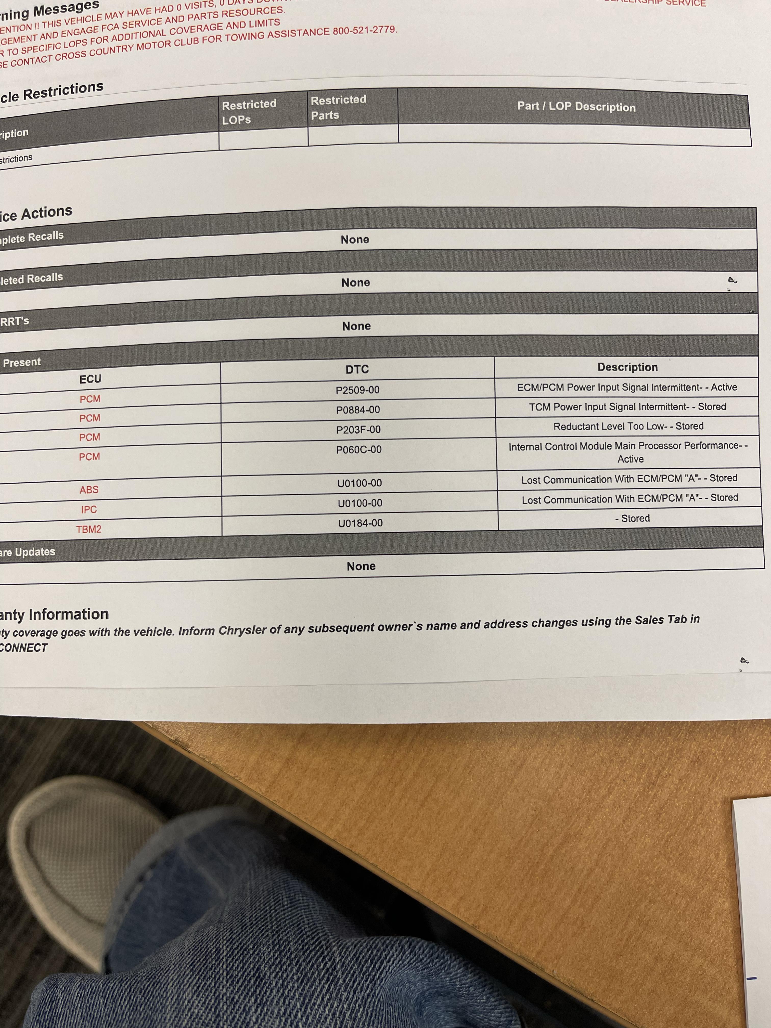

I was accelerating to get onto the freeway and the truck slammed/bucked noticeably, enough to jerk me forward. Dash cluster said “service fuel filter” and RPMs shot up and stayed around 2000-2500. Truck would get to speed and maintain but kept RPMs high. Made it to the dealer but the fuel filter code was not there. These are the codes that were present:
Just kidding, I just looked again and my code says “reductant level too low” instead of low flow. My mistake, sorry to derail.
I had half a tank of DEF though so not sure why it threw that one, might have been because the ECM was on the fritz.
