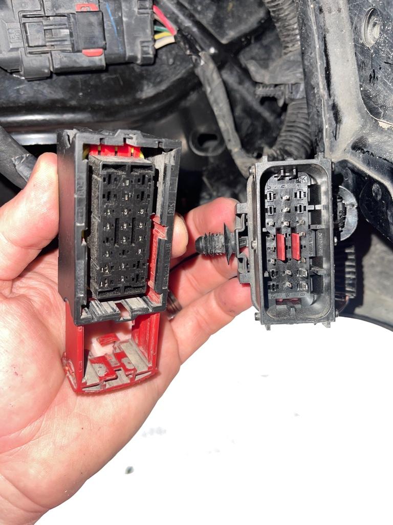

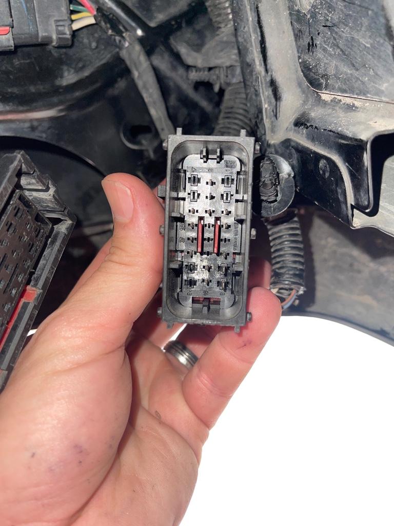

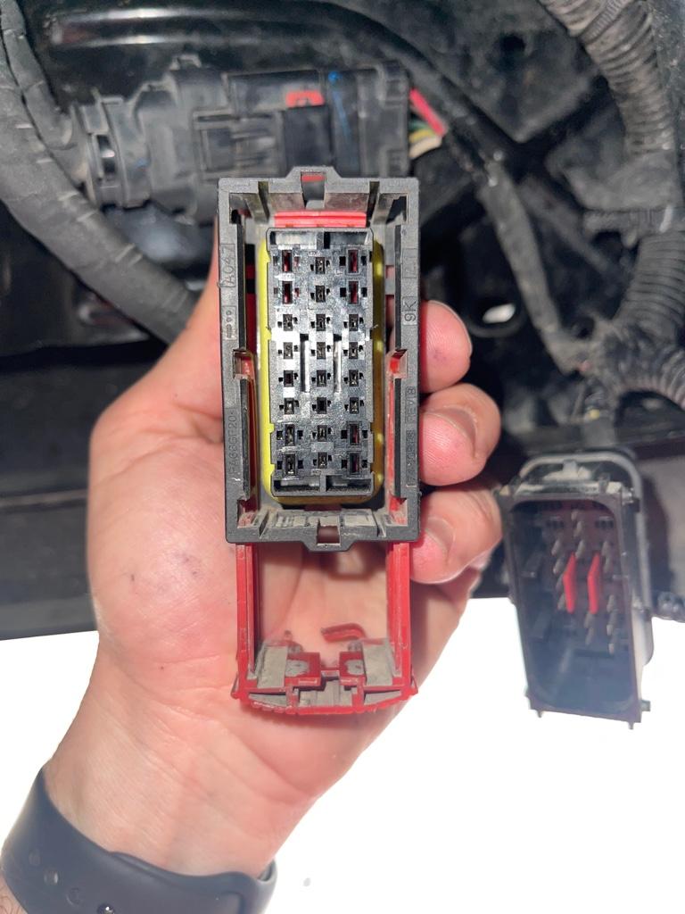

Had to remove my rear bumper to fix a dent and after putting everything back together I can’t seem to plug in the rear park sense harness back together. It just won’t plug back in. Any ideas on what I need to do to, tabs to push, etc etc are appropriated.
nvm. figured it out. Needed to push the two red vertical tabs up with a flathead screwdriver and then I was able to plug both ends together.
