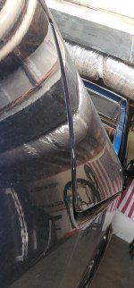

I have had multiple trucks with RAMBOX as an option. This 22' has the worst "twist" I have even seen. I do believe this to be a manufacturing defect as the passenger side does not have it. The adjustments are all the way in and you can get it to lay flat if you push down on it. @RamCares Do I start at the body shop or the service drive? You can see the resting position with the box lids from driver compared to passenger. Very disappointed with this fit and finish

@MegaStro do you by chance have the factory dividers in your RamBox? Mine did the same thing, and I noticed that a single divider was coming in contact with the lid forcing my drivers side box lid out just like yours. I grinded that one down and it shuts identical to the passenger side now. Just a thought…..

Never a divider or a full load of anything in the box. It has a few first aid items, additional hitch balls, a reaching pole for the bed, and an extension cords for the outlet if needed.
