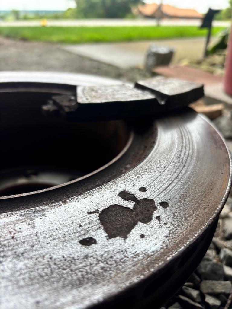

3) had to replace the right front brake rotor since that side wore twice as fast as the left

The brake rotor could have been from lack of maint on your part from the higher millage you should be lubing the slider pins and making sure the pads move freely every 5-10k miles
Electronics will have issues no mater the brand thats why a simple truck is better.
who on here or any HD truck forum is taking their brakes apart with the every oil change to make sure all is well?! Answer: no one. Doesn’t matter if the parts are garbage anyways.

You dont have to take the brakes apart to see if all is well. When tires are rotated you can quickly inspect the pads through the whole in the calliper and check the pin movement. When you are hauling heavy loads with an HD truck why would you not want to monitor your brakes…. It’s laziness or incompetence to not check your brakes periodically any when rotating the tires every 5-10k like you should its the perfect time to take 2 extra mins to check the brakes and if the pins or pads need to be cleaned up its an extra 10-15 mins per wheel if you are taking your time.
This is the back side of my right rear factory rotor @ 26k. You can see plenty of pad(both were even) and the calipers moved freely. I had a thumpy pedal since around 10k miles if I recall. The dealer(as it’s new and under warranty) stated they checked the brakes around 14k when the tailgate and other issues were addressed and determined all was ok and that I needed to drive the truck more. The truck gets driven plenty. The truck gets fluid film annually with plenty of washes throughout the year. I take care of it. Their parts are junk. It happens with all vehicles. I wasn’t pleased changing brakes on a pretty new vehicle but glad I did.
I agree with a visual when the wheels are off. Sorry OP for derailing.
