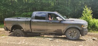

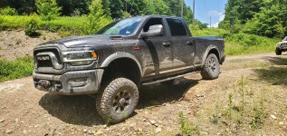

I will be picking up my 2019 PW in the next day or 2. I plan to put on 35’s but would like to keep the stock wheels. Was looking at the Nitto Ridge Grapplers, Wrangler DuraTracs, or Toyo Open Country RTs, but it looks like for 35 x 12.5 the approved rim widths are 8.5 and up. The PW wheel is 17 x 8. Do I need to go with 315/70/R17 instead?
Thoughts or suggestions appreciated.
