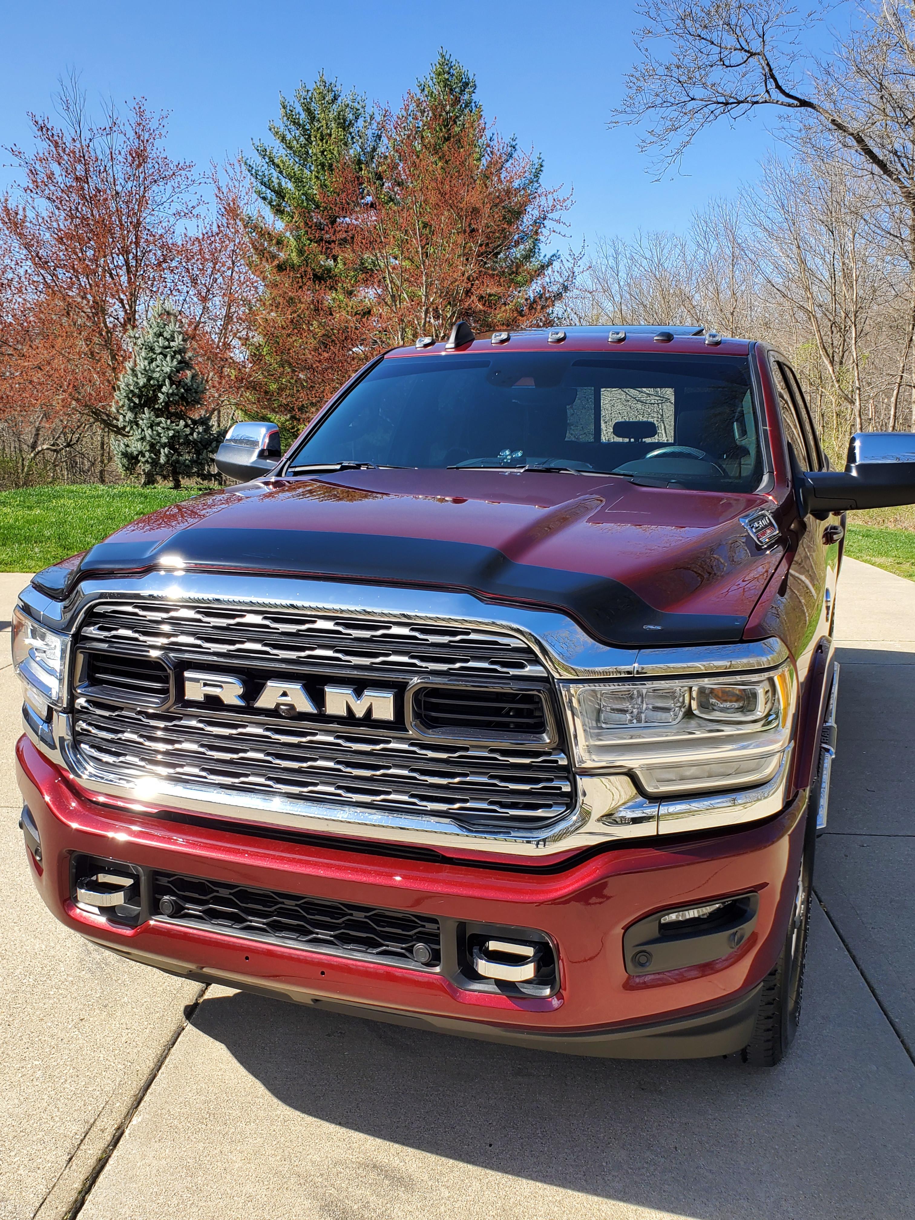

I'm searching for new wheels & tires for my 2020 2500 Limited, and I'm getting conflicting info on wheel sizes and offsets.
Note: my truck is STOCK HEIGHT with rear air suspension, and I don't plan to lift it.
Some tell me a 20x9 with zero offset will be flush. Others say 20x9 wheel needs to have +18 or +25 offset to be flush.
Is anyone running 20x9s on a stock height 2500? If so, please post a picture showing how much your wheels "poke" out, and tell me your wheel offset.
Much appreciated if anyone can help.
