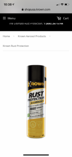

Nice video. Did you watch it Krown is not tested?
He's saying Krown was test and it didn't perform. Krown is pretty well known to be a crap product that markets incredibly well.
The first video posted in the thread tested Krown and it's a big fail.
PF did not test Krown, he probably knows better already.
I used Krown on my new Tacoma for two years. Works pretty good but seems to wash off easier then the FF. Either one beats nothing at all though. Wish I had known about these products sooner being from NY.
