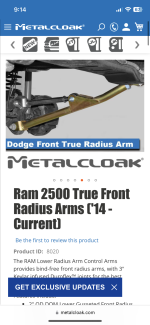

If I was going to change arms I’d probably do the metal cloak Y link style arms. Should give the same (or better) results due to the bushing design plus the benefit of adjustability, which is what I want so I can push the tire away from the pinch seam for true no trim 37s
The metal cloak arms do look nice, but if I can pick up a set of PW arms for a lot less then it’s easier to justify.
I'd 2nd the metal cloak arms - I have them on my build. My 36x13 toyos would rub under certain conditions and we were able to easily adjust that out with the arms which you can't do with the factory radius arms. I'll probably have to adjust them again when I go to 37s or 38s, but I'm waiting until I can do gears for that jump. Don't trust the RFE with meats that big plus the occasional towing I do.
