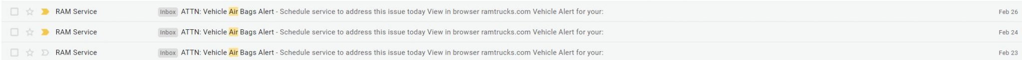

Come on March 17th! This is crazy for carrying a passenger, wife wonders if its just a jealous truck.... @RamCares need to look at the rental vehicle situation, I have a feeling I am giving up my truck for something other than a truck. Thank god for MAXCAREAir Bag Alert.JPG
