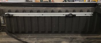

I have the Roll n' Lock M Series and modified the cargo rails so I could reinstall them. They are working well.
How well does this keep out water? Could you maybe post some pics of it closed and where/how it seals/runs? Thank you for the info you've already posted!
