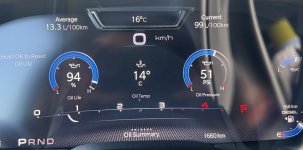

This first pic is what I expected.
The second pic is what my instrument panel is showing when on the same page.
I’d like it to show as the first example.
Digital readouts aren’t my friend.

The first one is a gas engine, yours appears to be diesel. That could be the difference since those gauges are real on a hemi and fake on the Cummins.

Odd that the gauges in the off road pages show the temp ring, but not instrument panel…

Mine does the same thing! I was just commenting about this to my wife.
I believe it displayed properly when I first got the truck, then went intermittent, and now never shows. I wondered about disconnecting the battery, or a reset at the dealer, but honestly I probably won't do a thing about it except complain in my little brain from time to time (unless you or someone figures out a fix).

I think the the digital instrument panel should have the oil temp gauge with a blue ring like all the other gauges. I want consistency, dammit!

Center stack on 12” works as it should.
The instrument panel does not.
It’s got to be a programming thing because it works on the gas models. Just not diesel.
I tried a new one at the dealership, and same issue.
Center stack works, but not instrument panel.

The big problem is we checked other trucks and they had the gauge working with the dial and the blue ring. I can change all 5 tiles to the same gauge and they show the same, nothing . Even when you scroll the pages to that page it will show nothing. Sorry one day it will have the ring around it another it will just show the number. I am on my 4th dash now with the same problem. The center was fixed with the one switch, it was mostly the Bluetooth was messed up. The off-road pages did work right with all the gauges . Its one hell of and expensive truck to not have it right.
The other thing is the gauges should be consistent in linear reading.
If you look at what 198°F is on dashboard, to what it shows on center stack , digitally they are the same, but the ring is further along on one and not the other.
It’s like having a tape measure that has inconsistent markings.
Some good engineering and approving there.

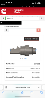

The isn't an oil pressure sensor or oil temperature sensor. There is an oil psi switch, so as long as you have 6 psi of pressure (10 psi is the minimum at idle per Cummins) our gauge will read "normal".
Curious about this, have seen your posts on multiple sites stating the oil pressure sensor is fake…are you sure about this on the newer 6.7s?
While the display may be fake or altered for whatever reason, the sensor being a 6 or 7 psi switch does not fly. This is a single wire switch (has two wires in connector, but only one used) that is normally grounded to block. If you check resistance static it is about .5 ohms & increases with pressure applied.
I can state with certainty it is not simply an on/off switch. Mine failed & I installed a 10psi switch, no joy.
Cummins even calls it a switch, not a sensor. The part crosses all the way back to 2007.
Not sure if it changed for 2025 or not.
