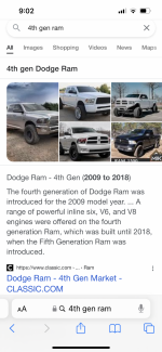

Thanks for that important (?) correction. Coming from the 1/2 ton world where the 4th gen ended in 2018. Now do you also know where I might find the information, kind sir?
Welcome to HDRams.
It's been beaten to death. Many groups/sites/forums capitalizing on incorrectly calling the 2019+ HD trucks 5th gen. Sometimes it's ignorance, sometimes it's about generating site traffic.
1. The HD platform is D2. It's been D2 since 2009.
2. The highest forum we have here is... 4.5 Gen.
3. When RAM designates a new platform number assuming it's whenever we ever get the 5th gen (or newer) cab, we'll change gens, at which time the Megacab fans will lose their minds..
4th generation did not end in 18 as they are still making the 4th gen now called 1500 Classic along with the 5th gens in the 1/2 tons, 2021 will be the last year for them from what i can tell as they dont offer a 2022 build and price on their website
