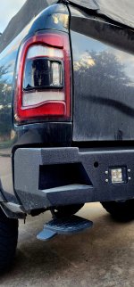

A bit late but that’s the correct one. It has the updated bracket/brace.
