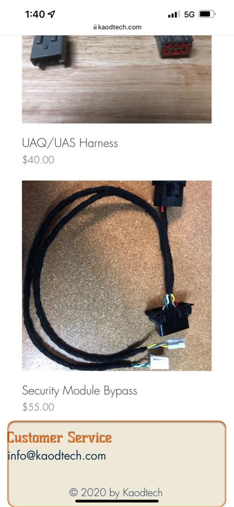

Thank you. Also do I need a by pass cable ? I’m doing some research and people are saying something about a by pass cable to make it work with the alfaobd
yes. need a cable. kaodtech is the one to get. the website may say out of stock, but they're built as ordered.
Would it be this one ^ ?

Will echo with the other posts here, don't waste the time with the adapters. Program them in and don't have to do the job twice like I did. KoadTech bypass is simple to install and the programming wasn't bad. You also don't have to get the expensive OBDLink Bluetooth model everybody gets. I got the wired USB version (EX). I prefer wired connections while doing programming.

How did you wire your bypass cable? I have 2022 ram 2500
I just followed the instructions on Koadtech's website. They color code the two wires and one goes into each connecting block behind the dash kick panel. It's really easy, just be careful with the connecting blocks and removing the connectors if you decide to remove it. I put mine in semi permanently.
