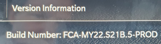

Interesting. The TSB says it requires a flash drive for the install and a file from Dealer Connect. Those updates are usually not OTA
I even called Regional Uconnect folks and still had to go to a dealer!
THAT'S IT. That's what mine said after a flash at the dealer.
