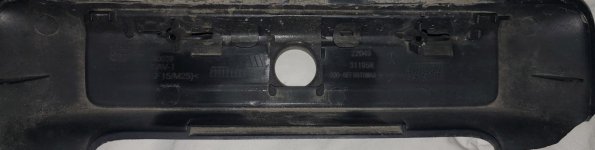

found the old handle, see pic attached. Which number is the part number?20230603_194751.jpg
found the old handle, see pic attached. Which number is the part number?View attachment 57832

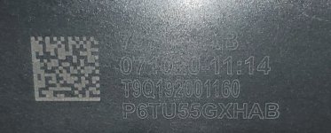

Forgot about this. The part number is on the back next to the QR code. It’s the line that starts with “P”, but disregard the P when searching up the part number.
That’s not it. You have to look at the back of the entire tailgate handle assembly, and the part number should be where I have the red arrow in the picture above. They don’t sell individual parts of the handle assembly.
found the part number you were referencing, P6TU55GXHAB
