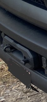

I also have the 7/16 Safe Xtract line. I haven’t had any issues with just the “hard dipped” loop, I just wedge it into the fairlead

Did you swap your fairlead to a Hawse style? If so, how did you go about it? Looks like it will need a spacer to get it closer to the face of the bumper.
