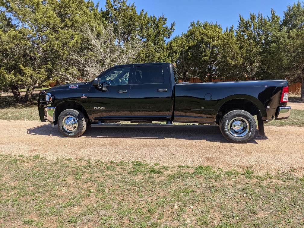

A SRW will certainly get it done, but DRW is a game changer when in tow. Simply nothing like it. One hand on the wheel towing experience at all times. The difference is unreal. I came from a 2016 2500 cummins and am completely shocked how easy the new DRW moves my 35' 14k toybox around.
I could DD my truck for a year straight with no issue. It has the OEM rear air assist so the truck rides very nice for a DRW.
