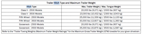

Yep, 2.5" Your options as others have mentioned are a sleeve (which used to be included with the vehicle but MAY now NOT be included, hard to say as some people buy used or didn't check or don't care or the vehicle POI team snagged it) or a new proper sized hitch, better weight rating included. Lot of discussion on the hitches people like here and why if you want to search further.
The B&W below seems well liked here.

It's not "poor" design, it all has to do with increased weight/tow ratings the newer trucks have. A 2" is only rated for 12,500lbs, and 2.5" is rated for 18,500lbs
