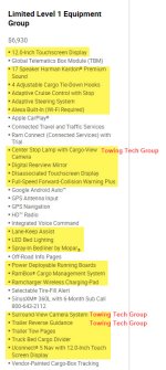

I am shopping for a new 3500 Limited CTD and will be towing a travel trailer. I have seen a few without the Level 1 Equipment Group but with the Towing Technology Package. I think I am OK with what I would give up, but wanted to make sure I’m not missing something important.
The graphic below is the list from the Ram website of what is included in the Level 1 Equipment Group. I yellow-highlighted the items that I think are truly added with the package – I think the non-highlighted items are actually included even without the Level 1 package?
Below are my thoughts on the highlighted items. Any input would be welcome.
Thank you!
- 12.6 inch screen – I am good with the standard 8.4 inch screen with Uconnect 5 Nav as I prefer the hard buttons for heated and ventilated seats
- 17 Speaker Harmon Kardon – would be nice but not a must have
- Adaptive Cruise Control, Adaptive Steering, Forward Collision Warning, and Lane Keep Assist (Safety Group) – I am okay without these
- Digital Rearview Mirror – is it a mistake to not have this?
- Bed Lighting – would like to have this but can live without it
- Power Running Boards – would like to have but can add Amp steps aftermarket
- RamBox – do not want this for my bed uses
Thank you!
