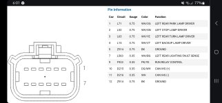

Need wiring help... Halogen to OEM LED tails
Awesome, thanks for responding! So basically 1-5 is the same for both connectors, and then 6 from the 6-pin goes to 7 on the 12-pin. Seems pretty simple, I'll post back once I finish mine!

I didn't realize this was a thing until my truck told me my left turn signal is out haha, I'll be using jscan since I have an iphone. Wiring complete! Your instructions were perfect, thanks for the help!
