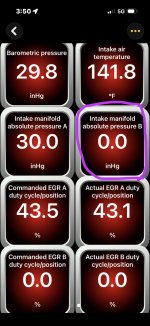

Does anyone know which MAP sensor “B” I have circled in purple is? Is it the one on the intake horn? I’m assuming the “A” is just after the MAF on the intake? Assuming “B” is a readable parameter, it should be reading something right? I’m having soot based regens every day over the past couple of days, makes no difference, TT in tow or not. Started when I did my recent LOF on my truck. Noticed MAP “B” was not reading. Everything else seems normal, I just cleaned the MAF and both MAP sensors just in case. Driving habits are the same and the air filter I’m using is the Fleetguard from Geno’s. Could that sensor not reading cause my soot load to jump up and not achieve a passive regen?
Has that PID ever read anything? I'm pretty sure that the BARO PID you have listed is read from the MAP on the air filter cover and the other reading you have is from the intake horn sensor.

No glue strips, to be honest I had those bunch of parameters on another page and didn’t really watch them, just soot load and associated stuff, until I started having problems.
