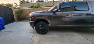

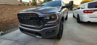

These are going on my truck tomorrow- Toyo RT trail.
For heavy towing that’s a bit big for the OEM 8” wide wheel, IMO. You want a tire that’s not too wide for the rim so you run a proper contact patch at the correct pressure for the load.
That tire is also 5% larger than stock, you you’ll likely feel reduced performance towing with the hemi.
The OEM rims are published at having a 3500lb load limit.
Just my 0.02.
Also just realized you’re not the OP, and have a HO. You won’t feel the gearing change as bad as the OP would, but still too wide on the OEM wheel, if that’s what you have, IMO.
Just my 0.02.
My apologies the rt is approved for 8" the rt trail starts at 8.5".
Any rubbing
Only when turning sharp, I haven't got down there to see where yet. I'm gonna do a level lift eventually, but I'm taking my trailer out this weekend and it was time for new tires on the truck.
