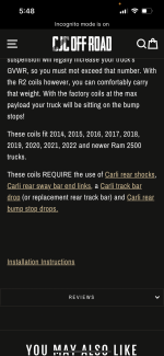

So I’d have to say that might be your problem.. they specifically say that you can’t just install the springs.. this is from the Carli 1” springs.. if you ‘left them out’ this might be your problem.. i almost got the rear springs but when i saw all the extra work and costs associated i decided not to.. for now

Install the rear links. They are designed for the Travel of the Rear Coil. Also the Factory shocks are not designed for the increased travel.
